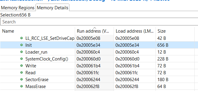

CubeProgrammer 2.0.4 could work with it successfully, but newer versions have the log output like this:
14:55:13:125 : UPLOADING ...
14:55:13:126 : Size : 1024 Bytes
14:55:13:126 : Address : 0x0
14:55:13:126 : Read progress:
14:55:13:127 : Reading data...
14:55:13:127 : halt ap 0
14:55:13:127 : w ap 0 reg 15 PC (0x20000000)
14:55:13:128 : w ap 0 reg 17 MSP (0x20000500)
14:55:13:128 : w ap 0 reg 16 xPSR (0x01000000)
14:55:13:128 : Loader read...
14:55:13:128 : Init flashloader...
14:55:13:128 : halt ap 0
14:55:13:129 : w ap 0 reg 0 R0 0x00000000
14:55:13:129 : w ap 0 reg 1 R1 0x00000000
14:55:13:129 : w ap 0 reg 2 R2 0x00000000
14:55:13:129 : w ap 0 reg 3 R3 0x00000000
14:55:13:130 : w ap 0 reg 4 R4 0x00000000
14:55:13:130 : w ap 0 reg 5 R5 0x00000000
14:55:13:130 : w ap 0 reg 6 R6 0x00000000
14:55:13:131 : w ap 0 reg 7 R7 0x00000000
14:55:13:131 : w ap 0 reg 8 R8 0x00000000
14:55:13:131 : w ap 0 reg 9 R9 0x00000000
14:55:13:131 : w ap 0 reg 10 R10 0x00000000
14:55:13:131 : w ap 0 reg 11 R11 0x00000000
14:55:13:132 : w ap 0 reg 12 R12 0x00000000
14:55:13:132 : w ap 0 reg 13 SP 0x00000000
14:55:13:132 : w ap 0 reg 14 LR 0x00000000
14:55:13:132 : w ap 0 reg 15 PC 0x20005E35
14:55:13:132 : w ap 0 reg 16 xPSR 0x01000000
14:55:13:133 : w ap 0 reg 17 MSP 0x00000000
14:55:13:133 : w ap 0 reg 18 PSP 0x00000000
14:55:13:133 : run ap 0
14:55:18:000 : halt ap 0
14:55:18:000 : Init function fail with timeout
14:55:18:002 : r ap 0 reg 16 xPSR 0x01000003
14:55:18:006 : halt ap 0
14:55:18:006 : w ap 0 reg 15 PC (0x20000000)
14:55:18:007 : w ap 0 reg 17 MSP (0x20000500)
14:55:18:007 : w ap 0 reg 16 xPSR (0x01000000)
14:55:18:007 : Error: Data read failedLooks like it reaches the Init function, but fails to execute it. Same thing happens even if this function just configures clocks and returns "1" informing for successful execution.
