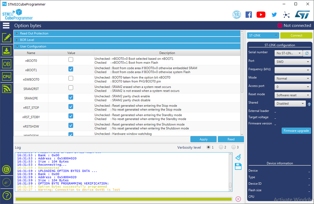

if you want to into DFU mode that you need change the nBOOT0 = 0 in option bytes and apply program in MCU as below picture
, and when you run the application code that you needs change the nBOOT0 back to 1, hope this has solved your problem!

Indeed you have to check the option bytes when you move from the SWD port to the USB port and vice versa.
But this is of no use if the SFSA option byte = 0.
Note a very important point: If you are using CubeWB FW package V1.5.0 and update the FUS to the new version 1.1.0, then you will be able to revert to the manufactory configuration (even with SFSA = 0) if you perform the sequence below:
This will prevent having a blocked board forever. After this sequence, the board is blank with only the last FUS V1.1.0 and the SFSA back to the value 0xF4.
