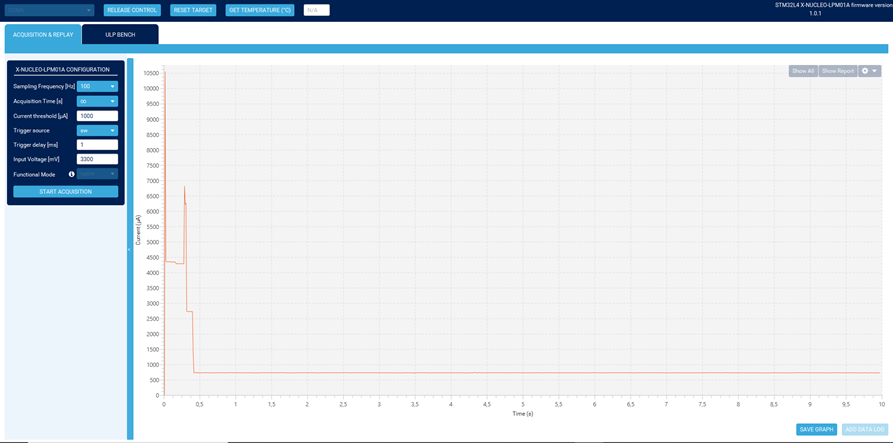

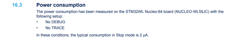

I want to check the low consumption in stop2 mode. I use directly the Sigfox_PushButton example of cubeWL
Page 71/79 of the AN5480 (Rev4 - July 2020) :

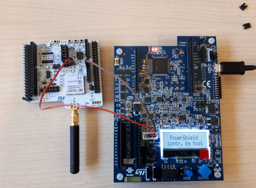

I use the X_NUCLEO-LPM01A to measure the consumption in stop mode. With this setup:
I supply the MCU through I_SoC (JP1) (at 3.3V)
I remove JP7 to remove LED5.
I remove STLK jumper (as shown in UM2592 P.22)
I measure : 725uA !!!
How in practice to measure these 2uA ?
Thank you

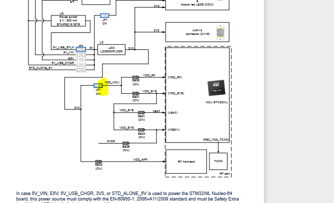

2022-01-28 12:48 AM
Hello @LLr.1
In the above measurement, you have to power-up the LDO (component U2) Figure 10. STM32WL Nucleo-64 board power tree because 3.3V is needed to supply the VDD_APP.
If you want to only supply the board through X_NUCLEO-LPM01A only, i would suggest to supply MCU through JP1 BUT keeping JP1 closed and unsolder SB1 to remove connection to LDO (otherwise it is seeking current when unpowered)
BR,
Bruno

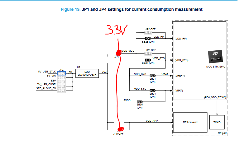

2022-01-28 1:36 AM
Thank you for your reply
OK, but removing SB1 is permanent. Can I solder a jumper ? (as I can be done with SB28/JP2 or SB27/JP3). (In order to change after this single measurement to 5V USB supply to flash the code et cetera.)
Nevertheless, I don't understand how the LDO can seek current because I supply thought JP1 which is open. see screenshoot :
NB: I managed to find the standby current of the datasheet by feeding here. (with simple PWR_STANDBY and POWER_STANDBY_RTC example)
Best regards
2022-01-28 2:12 AM
Ok, so just to be sure when executing Sigfox_PushButton did you power off/on the board and compile without debug in lpm mode ?
Can you measure again this scenario by powering the STLINK and VDD_APP ?
Seeking current though SB1 is not permanent but happens more on wakeups & TX/RX RF phases (as VDD_APP) is required. So it is just an advice to measure the consumption of the whole board without external power supply (ex USB STLINK connection) and reach the minimum consumption in the MCU range 1.71v to 3.6v.
Yes, you can solder a jumper. µ

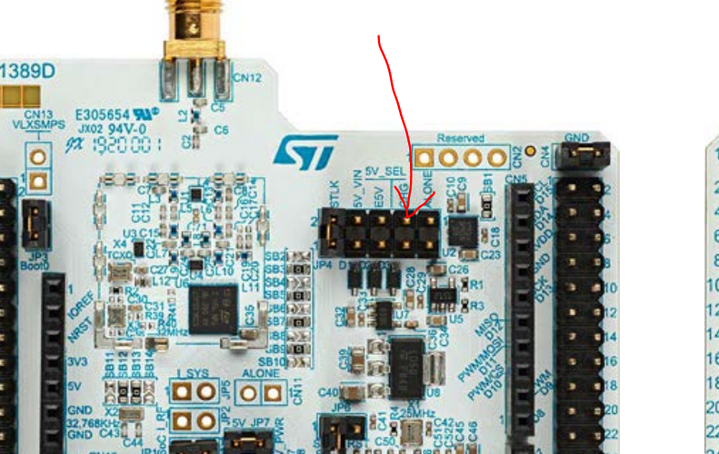

2022-01-28 7:14 AM
Thus, if I understand well your measure 2uA by removing SB1 and after I have to use external wires to feed in 3.3V JP1 and JP2 with the pin here ? :
Best regards
2022-01-28 8:09 AM
Let me do the same setup as you & i will get back to you soon.
BR,
Bruno

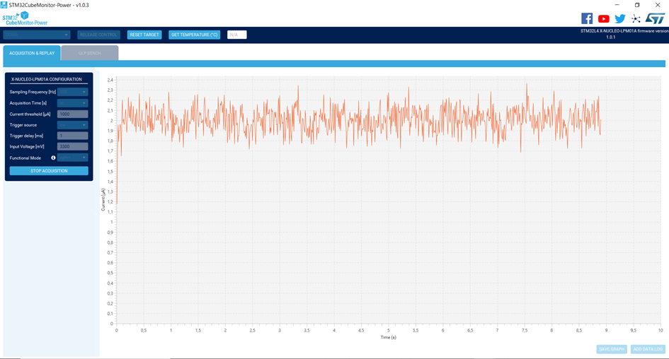

2022-02-07 4:49 AM
Thank you, I tested it on my side
1) "only power the nucleo via JP1 (X_NUCLEO-LPM01A) + remove all JP7 jumpers (so performs the measurement like shown in you first picture with JP7 removed) you get an overcurrent because of VDD_APP not beeing supplied (due to the RF switch U3). If you unsolder SB32 and solder a jumper on JP9 then disconnecting JP9 and you get your "2uA back (but RF is not functional anymore)." -> Ok, I have 2ua
2) "solder JP9 and supply both JP1 + JP9 external with X_NUCLEO-LPM01A." -> Ok, I have 2ua

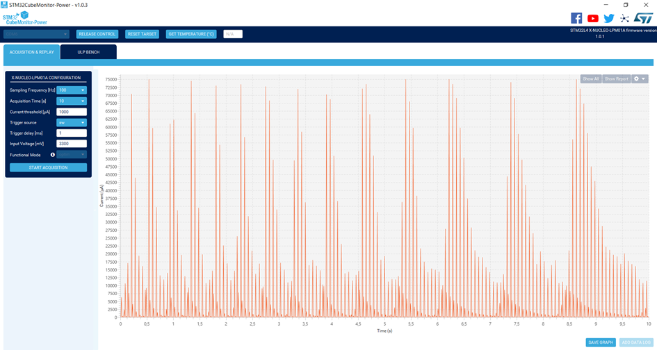

3) "If you power the nucleo with USB (STLINK) + JP1 via X_NUCLEO-LPM01A, you get effectively the 2uA in STOP2 mode in the Sigfox example." -> I don't have 2uA each time. I have (Is it the noise you talk about ?) : And if I restart the acquisition few times, I can have sometimes :
Thank you
