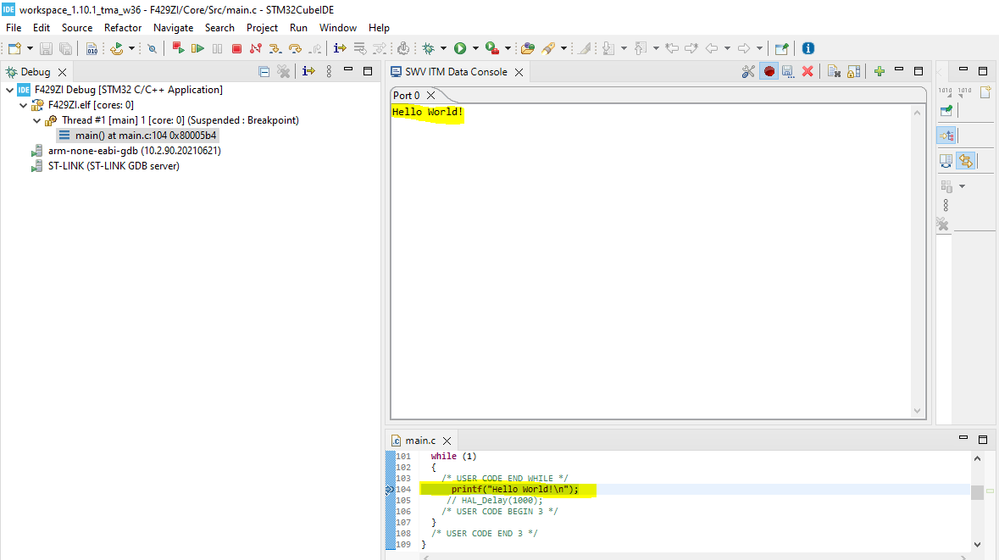

2022-12-15 6:42 AM
You could see this example in the screenshot bellow using CubeIDE 1.10.1 and NUCLEO-F429ZI.
