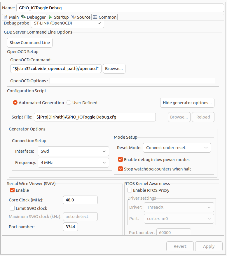

Did you know why it doesn't work? Is that possible to have serial wire on WL-55 ? I have all jumper on JP8 as we receive the nucleo-WL55.
My config :
Thanks

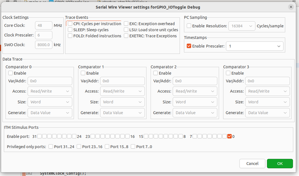

2022-12-05 8:10 AM
Before running you click on the Start/Stop trace (red button) Showen bellow?
Wijeden,
2022-12-05 8:12 AM
# This is an genericBoard board with a single STM32WL55JCIx chip
# Generated by STM32CubeIDE
# Take care that such file, as generated, may be overridden without any early notice. Please have a look to debug launch configuration setup(s)
source [find interface/stlink-dap.cfg]
st-link backend tcp
set WORKAREASIZE 0x8000
transport select "dapdirect_swd"
set CHIPNAME STM32WL55JCIx
set BOARDNAME genericBoard
# Enable debug when in low power modes
set ENABLE_LOW_POWER 1
# Stop Watchdog counters when halt
set STOP_WATCHDOG 1
# STlink Debug clock frequency
set CLOCK_FREQ 4000
# Reset configuration
# use hardware reset, connect under reset
# connect_assert_srst needed if low power mode application running (WFI...)
reset_config srst_only srst_nogate connect_assert_srst
set CONNECT_UNDER_RESET 1
set CORE_RESET 0
# ACCESS PORT NUMBER
set AP_NUM 0
# GDB PORT
set GDB_PORT 3333
set DUAL_CORE 1
# BCTM CPU variables
source [find target/stm32wlx.cfg]
# SWV trace
set USE_SWO 0
set swv_cmd "-protocol uart -output :3344 -traceclk 48000000"
source [find board/swv.tcl]2022-12-05 8:37 AM

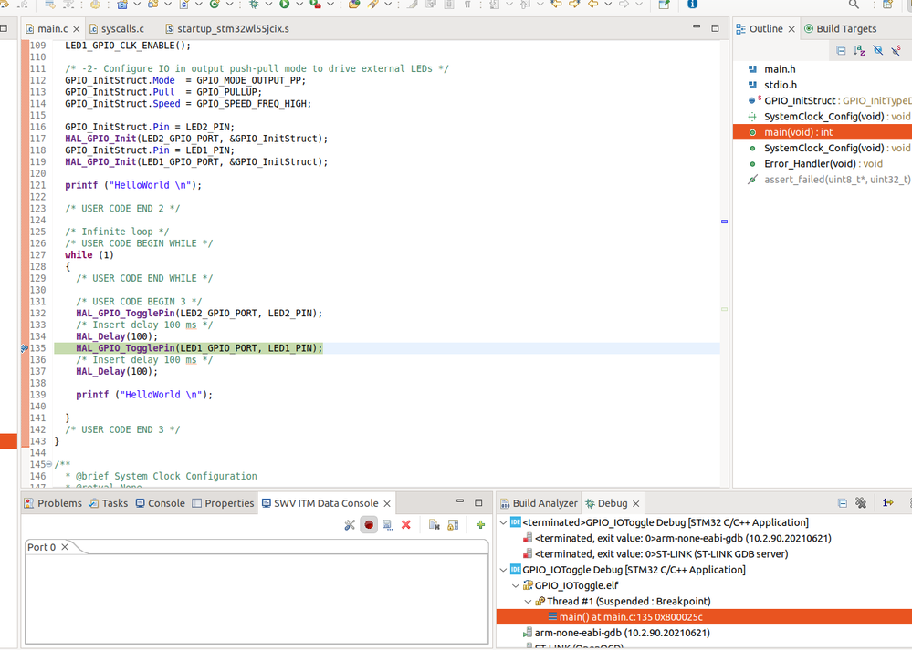

Yes as you can see red button is "ON" but still nothing on Port 0 !
