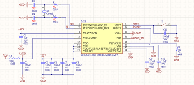

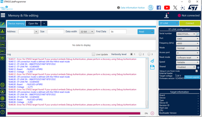

I designed my board using the STM32L476RGT6. However, when using the ST-Link via SWD, I get the following message:
Error: No STM32 target found! If your product embeds Debug Authentication, please perform a discovery using Debug Authentication.
I have checked all connections and voltages, and everything is correct, with the proper 3.3V values.
I am sending the schematic and a photo of the programmer.
Note: I did not solder the VCAP capacitors, and there is no voltage on these pins.

Do you use an ST-LINK debugger?
Have you wired NRST also to debugger header?
The "UR connection mode" seems to mean: debugger wants to connected Under Reset (it wants to force a reset and connect). But if you do not populate NRST to debugger - maybe the reason.

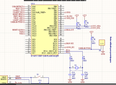

I measured 0V on the VCAP pins and a current consumption of 60mA (STM32L476RGT6 + LC76G), which I consider very high.
I am using the ST-Link from my Nucleo board, and when I reinsert the jumper, the STM32L4 on the Nucleo board works perfectly.
Additionally, I have already checked for possible shorts in the soldering or PCB and found none.
Could this be an issue with the MCU?

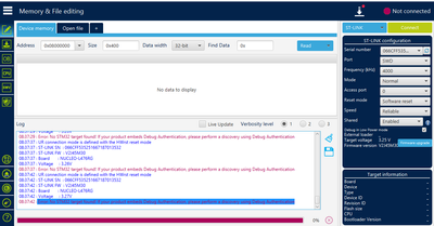

2025-03-05 3:43 AM
I checked my Nucleo-L476RG, and the VCAPs are jumpered to GND, as the datasheet states they are VSS. I tried doing the same, but it didn't work. I verified all 3V3 and GND connections, and they are okay.
Even so, the error message appears:
"Error: No STM32 target found! If your product embeds Debug Authentication, please perform a discovery using Debug Authentication."

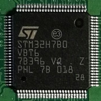

2025-03-05 11:20 AM
I found the error—I accidentally soldered the MCU rotated 360° (I confused the two markings on top of it). I corrected it, and now it works as expected.
Thank you very much for the help! I was able to learn a bit more with you.
2025-03-05 12:05 PM
360deg? then it would be the same.
There should be just one pin 1 marking, maybe two other "holes" for pressing the package.
Pin 1 should be on lower left corner and all the text is correct and readable.
This doc. might help next time:
2025-03-05 12:36 PM - edited 2025-03-05 12:37 PM
Good.
And reality looks like this:
So "a dot" is not the important thing to look for, but the alignment of the font (to read it) - and then to decide, what is the "lower left corner" with the pin1 mark.
