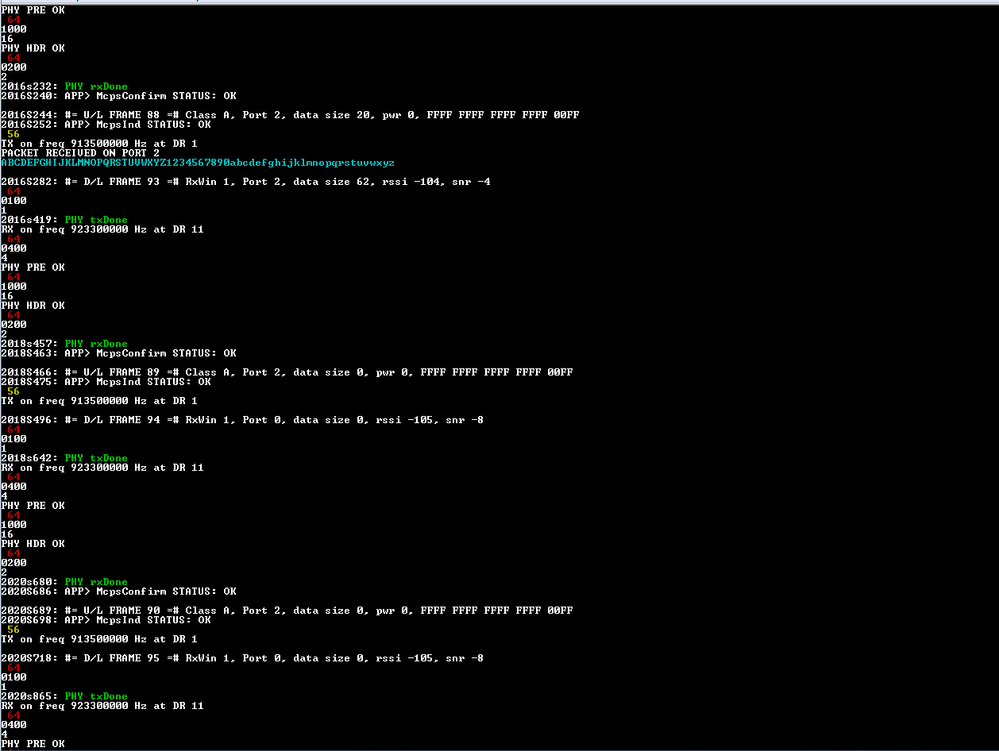

Here I am attaching my logs. please guide me .

Thanks for the reply, I got RX done in my code when changes the RTC Configuration but still some time I am facing RX Time out, Can you please guide in stack at which point Rx timer start for receive window?

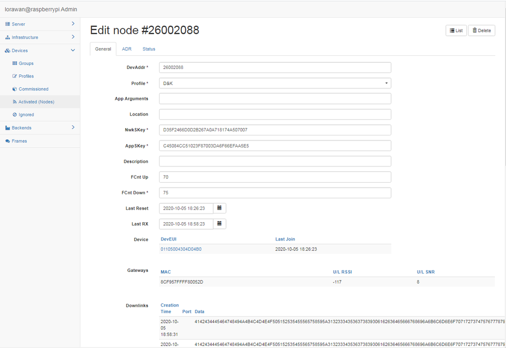

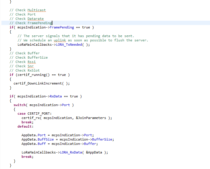

I am facing 1 more problem when on my server there is a multiple down links are there at that time i am receiving only first frame. other frames are flushed. I noticed that during that time continuously LORA_TxNeeded function is calling. Can you please guide me to solve this issue.

Grep or find-in-files RxTimeoutTimer, typically in the Radio BSP code
STM32CubeExpansion_LRWAN_V1.3.1\Drivers\BSP\Components\sx126x\radio.c
Indicative of it not completely receiving any data during window.
The timeout must include reception time of packet, it can fire mid-data.
Watch for dead-time when you aren't receiving/listening for traffic, watch particularly what you waste time on after "TxDone"
Could be that it is simply not seeing any data on the frequency/channel you've picked, make sure the radio is configured to the right place to see the transmitted data. Dump the registers, double check.

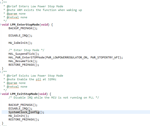

my Frame missing during multiple down links Frames are solved from server side. During my testing I am facing LoRaMacIsBusy() function return True after that my node unable to send a data to the server. Also, I want to use stop mode In my code for that I am using default flow of I cube lrwan, but node is not going in to stop mode it's suddenly weak up after calling HAL_PWR_EnterSTOPMode(PWR_LOWPOWERREGULATOR_ON, PWR_STOPENTRY_WFI); I am using SX1262DVK1DAS file for sx1262 which available in example

Regarding the stop mode issue, I-CUBE-LRWAN FW package supports the SX1262DVK1DAS RF shield from Semtech but has never been tested with any LoRa module from NiceRF. Moreover the code you show is not the same as the one we provide in our package. So it is very hard to support you as you are using a modified code with a not supported HW. I have no idea about what is not working and why.

The code is default code which is provided In I Cube LRWAN. I am just call SystemClock_Config for configure my clock after wakeup from stop mode.
