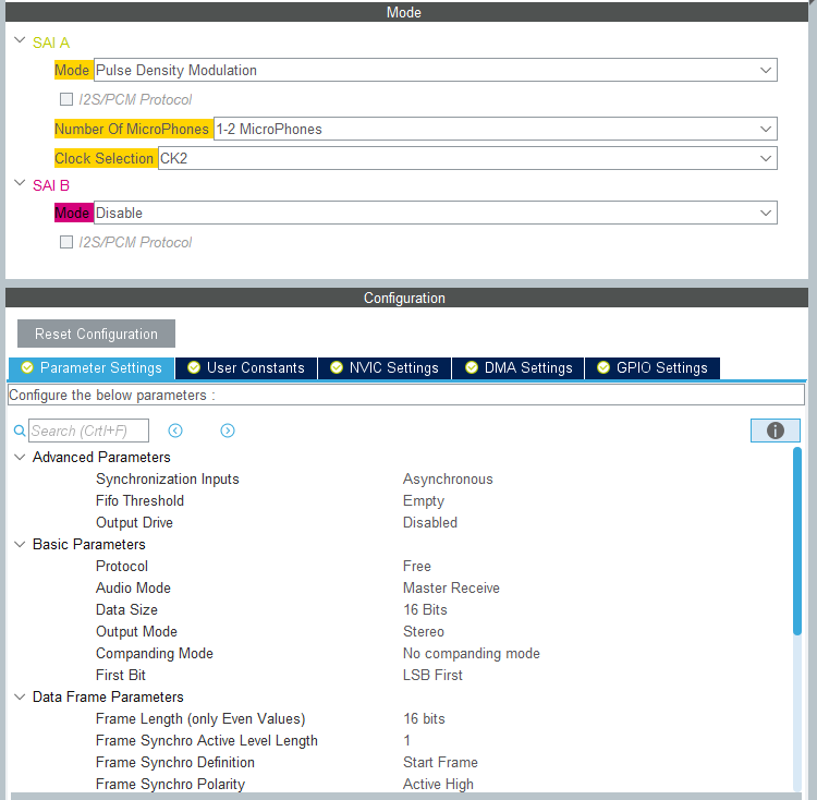

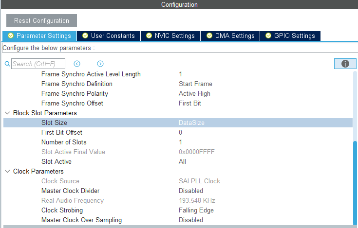

I'm trying to enable the PDM interface on a STM32WB55RGV with one microphone. Basically i followed the AN5027 application note, but I'm not able to start the clock on the proper GPIO.
The configuration from CUBE-MX seems ok, and I checked the registers value, so maybe I'm setting up the wrong API to start the streaming.
Any advice?

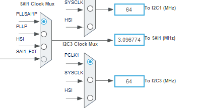

How is SAI clock set in RCC?
Read out and check/post content of relevant RCC, SAI and GPIO registers.

I don't use Cube and don't understand its gibberish.
It appears you are using the SAI PLL's output - is that PLL running? Maybe there's no simple way to test that on your STM32 model, then use for SAI for testing a clock you are sure it's running.

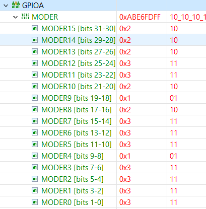

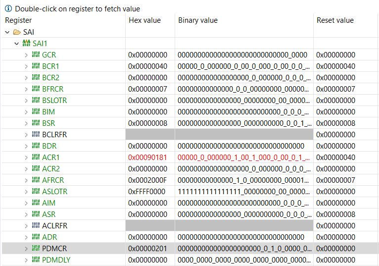

Thank you su much.
Here the SAI registers:
The RCC :
and lastly the GPIOs configuration:
PA10 is the SAI_D1 and PA8_SAI1_CK2
2019-10-18 9:13 AM
OK and GPIO_AFRx is set to the appropriate AF?
I have no experience with SAI with PDM, so you may want to check that yourself against the RM.
Did you make sure there is a valid clock input in RCC, maybe switching to a clock source which is known working (such as the main PLL)?

The issue comes from the RCC, selecting the PLLP clock source instead of PLLSAI1 the PDM peripheral works. It seems an CUBEMX bug generating the RCC config function.
