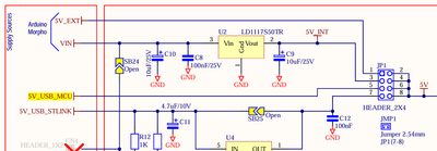

Do I just remove the JP1 jumper and connect the SWD pins (SWD, SWDIO, GND, VDD, NRST) between boards?

But yes, if you connect SWDIO/SWCLK/GND/SWD at the JP5 header, it should work. JP1 is a power header, doesn't seem relevant here.
2025-09-16 9:58 AM - edited 2025-09-16 9:59 AM
@TDK External power is 3.3V here, not 5V. I am afraid of the regulator's output affecting the 3.3V input
