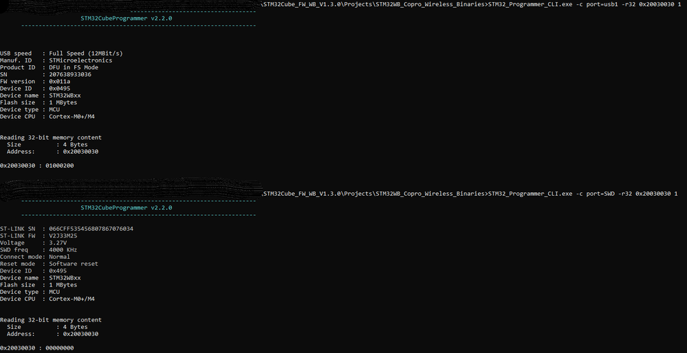

But there is still a problem, I can not see FUS version like with USB Dongle with the following command (usb1 is usb dongle connected and SWD is Nucleowb55 connected) :
And when I try to execute "STM32_Programmer_CLI.exe -c port=SWD -fusgetstate", it says me that this command is still not available with SWD, but if I am not wrong, I succeeded to activate FUS in USB Dongle by launching this command twice, but there I cannot so no activation of FUS and then no activation of Wireless stack. Am I doing something wrong ?
2019-10-22 7:54 AM
>this command (-fusgetstate) is still not available with SWD

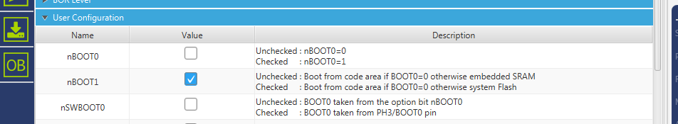

Thanks to support team by email, we found the solution to connect to DFU Mode. Via STLink and STM32CubeProgrammer, I configured user configurations like the following :
That way, it does not rely on PH3 pin and I can connect to custom board and eval board in DFU Mode !
