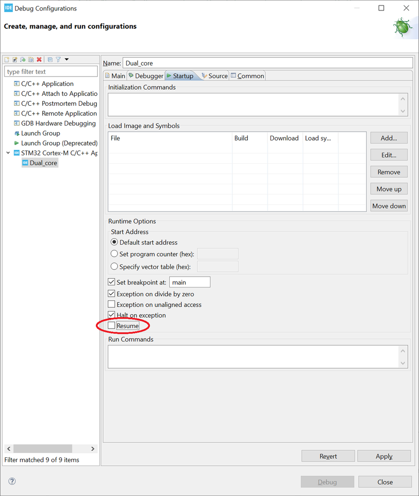

If you're trying to debug the bootloader you might need to uncheck the "Resume" box in the startup tab of your debug configuration:
Also, there is an application note made about this that you can find here.
