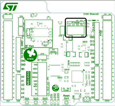

2023-11-06 11:52 PM
Hello @Sjain and welcome to the ST Community.
I suggest you to verify the position of the JP1 is compatible with the 5V source that you are using or not.
In your case, the Jumper should be on the USB-STL.
Best Regards.
STTwo-32.
