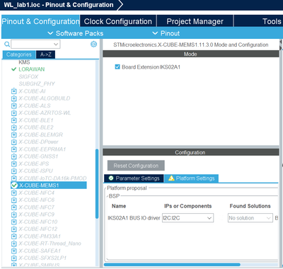

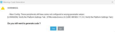

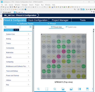

I’m testing the End Node application on the NUCLEO-WL55JC1, but the RF pins are shown in pink (not activated). Also, when I generate code, I get this message: Main Config: These peripherals still have some not configured or wrong parameter values: [LORAWAN, Verify the Platform Settings Tab , STMicroelectronics.X-CUBE-MEMS1.11.3.0, Verify the Platform Settings Tab ]. The application doesn’t work. Any idea how to solve this?

In this project, I successfully tested the Stop Mode on the NUCLEO-WL55JC1, and the functionality worked as expected. However, when I attempted to extend the work towards radio communication (LoRaWAN), I encountered blocking issues. Specifically, while testing the End Node application, the RF pins appeared in pink (inactive) in CubeMX, and during code generation the following error message was displayed:
As a result, the radio part of the application could not be tested. Another limitation of this work was the unavailability of a LoRa gateway, which prevented me from verifying a complete end-to-end communication setup.
I already sent you the picture of the error. The application still doesn’t work. Do you have any idea how to solve this?
