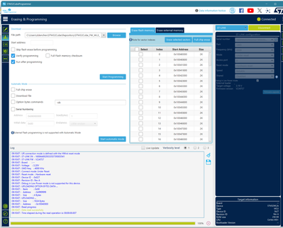

So far there is only one partial success - Using STM32CubeProgrammer + ST_LINK V2 and Chinese modile - I can connect, flash and verify some ELF file:
08:47:13 : UR connection mode is defined with the HWrst reset mode
08:47:13 : ST-LINK SN : 16004A002933353739303541
08:47:13 : ST-LINK FW : V2J46S7
08:47:13 : Board : --
08:47:13 : Voltage : 3.20V
08:47:13 : SWD freq : 4000 KHz
08:47:13 : Connect mode: Under Reset
08:47:13 : Reset mode : Hardware reset
08:47:13 : Device ID : 0x027
08:47:13 : Revision ID : Rev A
08:47:13 : Debug in Low Power mode is not supported for this device.
08:47:14 : UPLOADING OPTION BYTES DATA ...
08:47:14 : Bank : 0x00
08:47:14 : Address : 0xf9f9f9f9
08:47:14 : Size : 4 Bytes
08:47:14 : UPLOADING ...
08:47:14 : Size : 32768 Bytes
08:47:14 : Address : 0x10040000
08:47:14 : Read progress:
08:47:14 : Data read successfully

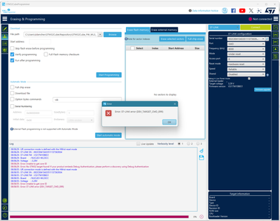

Whentrying the same test with NUCLEO-WL33CC1 board, it still fails, but in slightly different way.
With Programmer:
09:47:19 : UR connection mode is defined with the HWrst reset mode
09:47:19 : ST-LINK SN : 002C00413433511137363934
09:47:19 : ST-LINK FW : V3J17M10B6S1
09:47:19 : Board : NUCLEO-WL33CC
09:47:19 : Voltage : 3.29V
09:47:19 : Error: Unable to get core ID
09:47:19 : Error: No STM32 target found! If your product embeds Debug Authentication, please perform a discovery using Debug Authentication

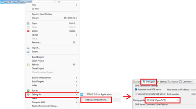

It seems that this was a known limitation and the workaround is to use ST-LINK (OpenOCD) option.
So in your project, change the Debug probe config from ST-LINK GDB server to ST-LINK OpenOCD setting:
Normally it should work .. I tested it.

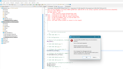

When trying to connect in Cube IDE environment I am getting the following error message:
... so I tried again with the STM32Programmer tool... again without success. In Programmer tool there are no debug options, to choose, but it is clearly visible that the embedded ST_LINK V3 is unable to connect to the tartget. I am not sure is this meanigfull, but on every next attmpt to connect, the error messages alters:

I did also experiment to use the MB1801 board as a ST_LINK V3 interface and to try to debug my custom STM32WL33KC board with CubeIDE. The weird think is that if I try to debud project for STM32WLCC I am able to connect and debug it:
Open On-Chip Debugger 0.12.0+dev-00645-g2306f32ee (2026-02-09-11:36) [https://github.com/STMicroelectronics/OpenOCD]
Licensed under GNU GPL v2
For bug reports, read
http://openocd.org/doc/doxygen/bugs.html
Info : Listening on port 6666 for tcl connections
Info : Listening on port 4444 for telnet connections
Info : STLINK V3J17M10B6S1 (API v3) VID:PID 0483:3753
Info : Target voltage: 3.295808
Info : clock speed 8000 kHz
Info : stlink_dap_op_connect(connect)
Info : SWD DPIDR 0x0bc11477
Info : [STM32WL33CCVx.cpu] Cortex-M0+ r0p1 processor detected
Info : [STM32WL33CCVx.cpu] target has 4 breakpoints, 2 watchpoints
Info : [STM32WL33CCVx.cpu] Examination succeed
Info : starting gdb server for STM32WL33CCVx.cpu on 3333
Info : Listening on port 3333 for gdb connections
Info : accepting 'gdb' connection on tcp/3333
undefined debug reason 8 (UNDEFINED) - target needs reset
Error: [STM32WL33CCVx.cpu] DP initialisation failed
[STM32WL33CCVx.cpu] halted due to breakpoint, current mode: Thread
xPSR: 0xf1000000 pc: 0x100017c0 msp: 0x20008000
Info : Padding image section 0 at 0x10041d48 with 8 bytes (bank write end alignment)
but if the project is for STM32WLKC, it is still failing:
Info : Target voltage: 3.297405
Info : [STM32WL33KCVx.cpu] Cortex-M0+ r0p1 processor detected
Info : [STM32WL33KCVx.cpu] target has 4 breakpoints, 2 watchpoints
Info : [STM32WL33KCVx.cpu] Examination succeed
Info : starting gdb server for STM32WL33KCVx.cpu on 3333
Error: [STM32WL33KCVx.cpu] DP initialisation failed
[STM32WL33KCVx.cpu] halted due to breakpoint, current mode: Thread
Info : Padding image section 0 at 0x10046234 with 12 bytes (bank write end alignment)
Error: timed out while waiting for target halted
Error: error waiting for target flash write algorithm
Error: error writing to flash at address 0x10040000 at offset 0x00000000
[STM32WL33KCVx.cpu] halted due to debug-request, current mode: Thread
Info : dropped 'gdb' connection
shutdown command invoked
