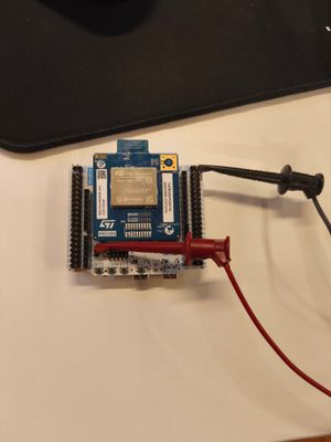

I am using a Keysight B2901A for measurement. Connected directly to the MCU board.

I mean the schematic of how, exactly, you are connecting the SMU to the board.
2026-04-10 1:46 AM
I am connecting like this:
2026-04-10 1:51 AM
So you still have the mezzanine board attached!
My suggestion was that you remove the BLE board from the mezzanine - thus completely disconnecting everything, and ensuring that you are powering only the BLE part.
2026-04-10 1:52 AM
I have already tried that.. in that case I connect Vdd into PIN1 of CN4 and GND into PIN3 of CN4.
