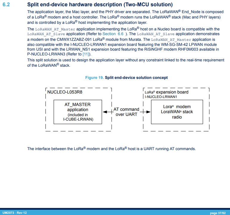

The L073RZ controls the USI module via AT commands - so you need to program it with the code for that.
IIRC, it's called "AT Slave" or somesuch ...
2025-06-02 2:37 AM
@Andrew Neil wrote:IIRC, it's called "AT Slave" or somesuch ...
This:
via: https://www.st.com/en/embedded-software/i-cube-lrwan.html#documentation
