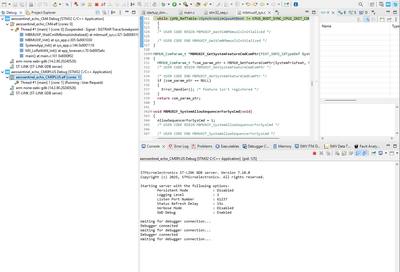

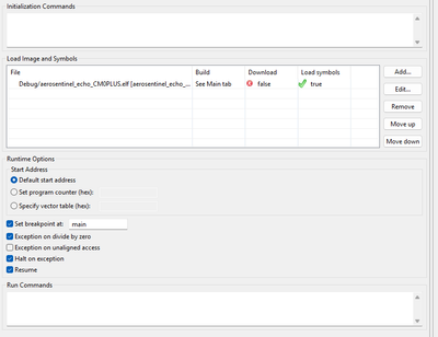

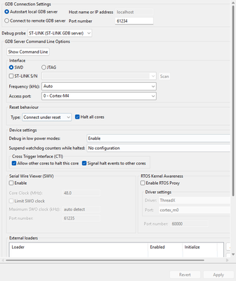

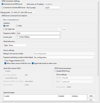

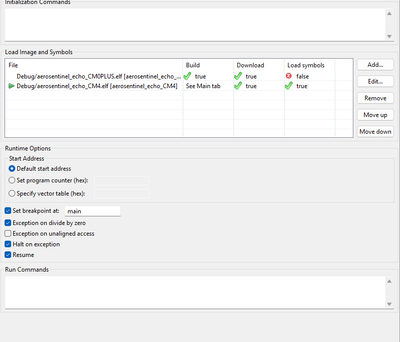

I have some updates! I managed to solve the errors that i got, but now when i launch a debug session I'm struggling to launch the M0+ core correctly. Here's my debug configurations:
M4 :
M0+:
So in my scenario, i launch the Debug session on the M4 Core first and click on Resume. The result on TeraTerm is the following :
4194303s999:
CM4: System Initialization started
4194303s999:CM4: System Initialization done: Wait for CM0PLUSAnd here's the screenshot of CubeIDE :

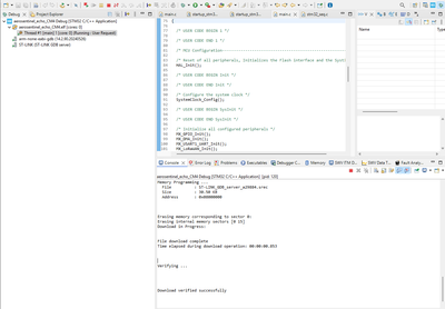

Then i launch the Debug session on the M0+ core but I'm not able to click on the Resume button :
The only thing I can do is to click again the Resume button on CM4 but nothing else. I'll attach the new .ioc file for reference.
Can someone please help?

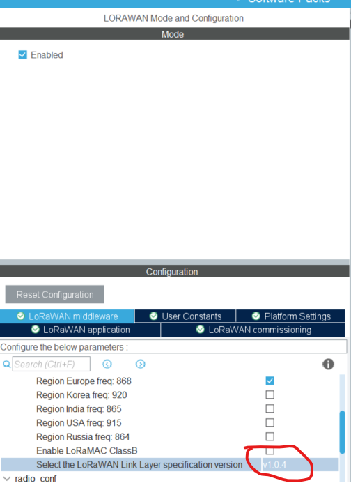

I am having the same compiler error:
LoRaMac.c:1650:40: error: 'McpsIndication_t' {aka 'struct sMcpsIndication'} has no member named 'ResponseTimeout'
while using STM32CubeIDE V1.17.0 and the STM32CubeWL V1.3.1.
Should I use the Cube IDE v1.18.0 ? How to fix this ?
2025-05-15 7:03 AM
Ok, found the issue. The Lora link layers version must be v1.0.4 and not v1.0.3
