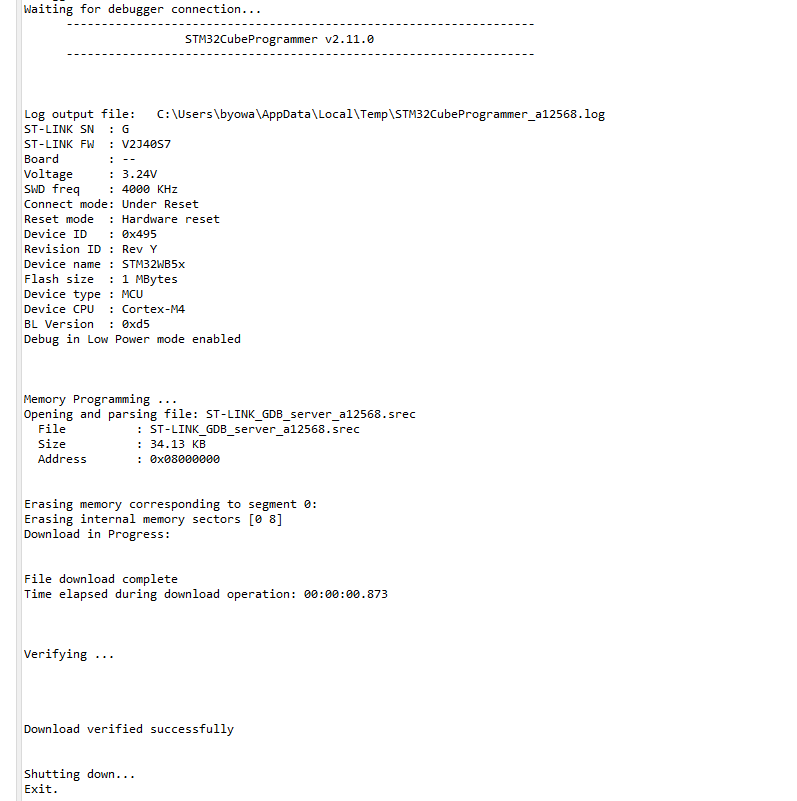

Here is the output of STM32CubeIDE on flashing the custom board:
On STM32CubeProgrammer I am not able to consistently get a connection (by hitting the connect button).

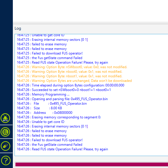

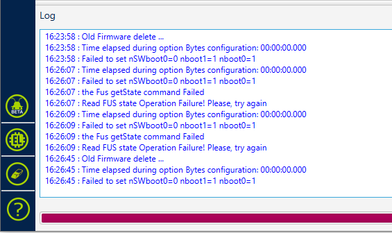

Here's some screenshots of the outputs I've seen while attempting to write to the FUS using Programmer:
I've had a hard time figuring out how to approach debugging this issue since I have not been able to get consistent results.

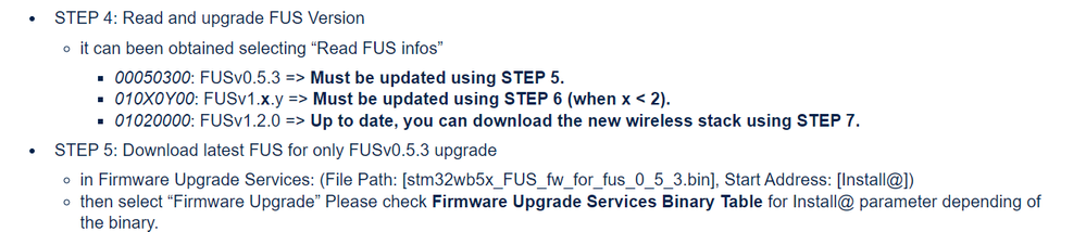

Then try write where you stuck
How to flash the Wireless Coprocessor Binary via SWD/JTAG by ST-LINK (STM32CubeProgrammer GUI)
Inside the below procedure, the references to binaries name and install address are provided in the section Main Changes of this file.
STEP 1: Use STM32CubeProgrammer GUI
Version 2.7.0 or higher.
It gives access to Firmware Upgrade Service (FUS) (AN5185 : ST firmware upgrade services for STM32WB Series.) through Bootloader.
It is currently available as Graphical User Interface (GUI) mode (or Command Line Interface (CLI) mode).
STEP 2: Access to SWD Interface (system flash)
For P-NUCLEO-WB55.Nucleo :
Power ON via ST-LINK and Jumper JP1(USB_STL)
For P-NUCLEO-WB55.USBDongle :
remain switch SW2 to Boot1
Connect P-NUCLEO-WB55.USBDongle
For STM32WB5MM-DK :
Power ON via ST-LINK and Jumper JP2(USB_STL)
open STM32CubeProgrammer GUI and select “ST-LINK�?
in ST-LINK configuration: (Port: SWD) then select “Connect�?
STEP 3: select “Start FUS�? in Firmware Upgrade Services
STEP 4: Read and upgrade FUS Version
it can been obtained selecting “Read FUS infos�?
00050300: FUSv0.5.3 => Must be updated using STEP 5.
010X0Y00: FUSv1.x.y => Must be updated using STEP 6 (when x < 2).
01020000: FUSv1.2.0 => Up to date, you can download the new wireless stack using STEP 7.

You can see from my post the outputs I get when I attempt to Fuse read, I have followed these steps and gotten it to work on my nucleo board. But I get these error results when i attempt to use my custom board.
But this only sometimes works, most of the time clicking "connect" in the Programmer does not work and there's no feedback from the App. This is strange because I have no issues programming via the IDE.

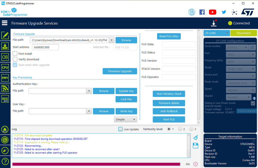

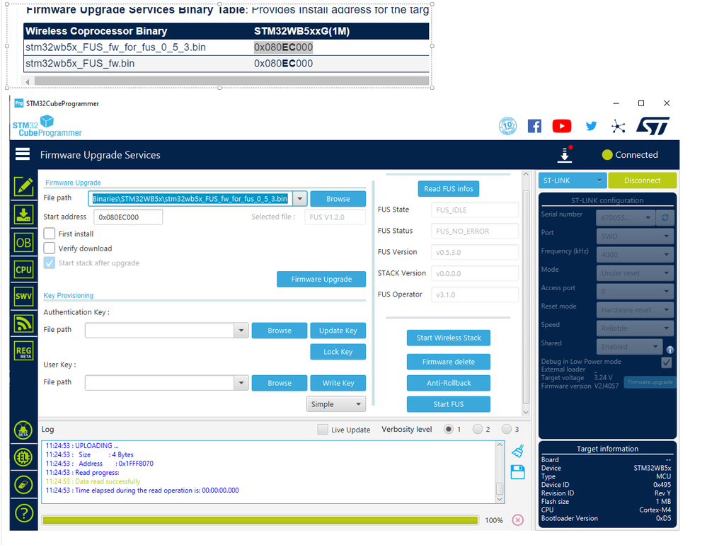

The configuration is identical for both IDE and Programmer, I copy the configuration stated in the IDE during flashing:
I am able to connect and read the FUS. I read that the version is FUSv0.5.3

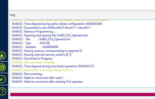

Because of this I jump to step 5 in the release notes and upgrade the FUS:
Upgrading:
This is the point that I get the error and the board becomes unresponsive. The only way to restart the communication is to reset the board completely and restarting the ST-Link. Here is the error message I get:
After the restart the FUS has not been upgraded, so I am stuck here:
Maybe it's because the STM32CubeIDE does not read/upgrade the FUS? Is there anything specific to FUS that may be broken here?
Thanks very much again for your input.
