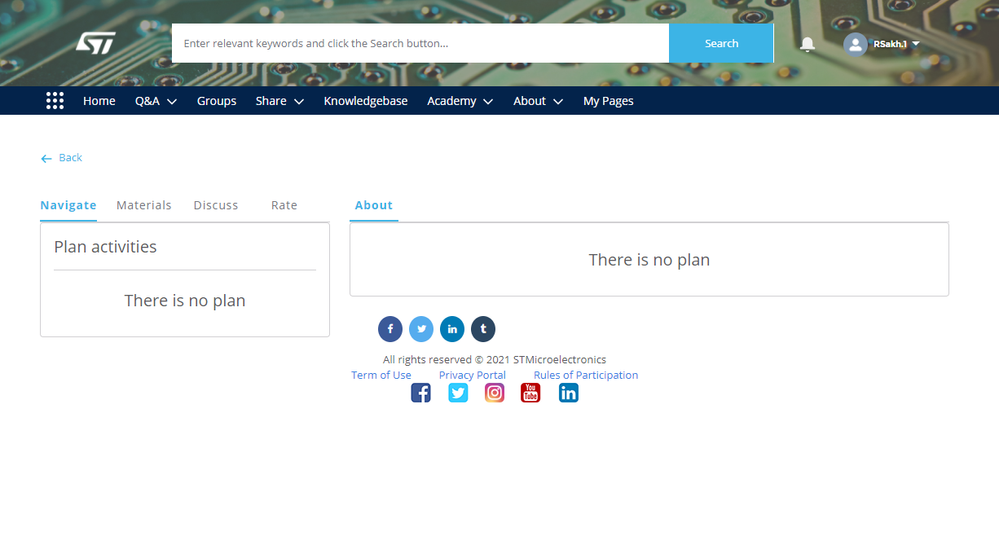

When click on "Access the Course" I don't see any material in it, below is screen shot. I have log-in credentials registered on STM.
 0693W00000BdYegQAF.pngIs there anything I am missing here ??
