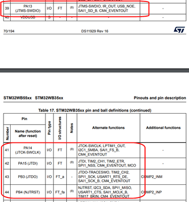

Look at the pins:

Hello @Nour
As a short answer, the JTAG interface is available for debugging on the STM32WB5MM-DK. The JTAG on the STM32WB55VGY (MCU implemented on your DK board) is available using the Pins PA15, PA14, PA13, PB4 and PB3. Those pins are available on the different connectors of the STM32WB5MM-DK. So, you can use them as JTAG pins. For such information, you always need to refer to the datasheet of the used MCU first, then you go to check if they are available on board or not.
