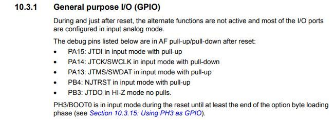

Maybe you should check the GPIO pins settings through which you run the debugger. For that your can refer to the GPIO chapter in the RM0453.

The projects are delivered to reach low current consumption in stopmode2 by default.
Therefore the project switches off the SW pins (PA13 and PA14). This is why you loose debugger connection
This is done in Core/Src/debug.c file.
Note: to enable the debugger, and you can set the definition of DEBUGGER_ON to in Core/Inc/sys_conf.h
moreover, it is advised to set LOW_POWER_DISABLE to 1 to disable stop mode while debugging
