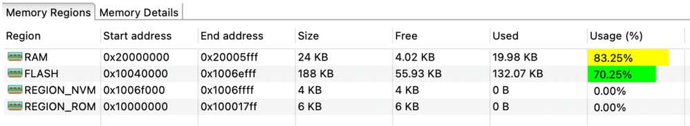

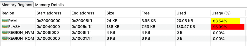

The major problem we are facing when we build the image with a release build it's going around 80% and debug it's going beyond 90%
Release Build
Debug Build
