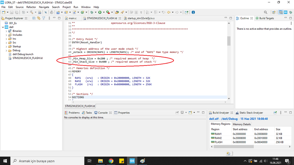

Default values of the _Min_Heap_Size and _Min_Stack_Size is setting according to What? I changed these variables from 0x200 , 0x400 to 0x00 and 0x00 resprectively ,end then no problem,no error .I guess that Static and dynamic variables in RAM are in the RAM Base Addr + (_Min_Heap_Size or _Min_Stack_Size ) . Why are they 512 byte and 1K byte as default?

I can't understand what these (_Min_Heap_Size and _Min_Stack_Size) default values are respect to. The Values of an another ST MCU which has a different RAM size are different others, for example instead of this:
_Min_Heap_Size = 0x200 ; /* required amount of heap */
_Min_Stack_Size = 0x400 ; /* required amount of stack */
like this:
_Min_Heap_Size = 0x100 ; /* required amount of heap */
_Min_Stack_Size = 0x200 ; /* required amount of stack */
If I need to ask for you more clearly , Are These DEFAULT values chosen randomly or else is there a special reason?
