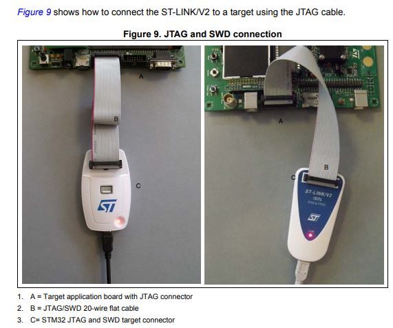

You need to connect the ST-LINK to a target using the SWD cable as you can see below.
You can check the SWD pins connections in the UM1075, Table 4. JTAG/SWD cable connections.
