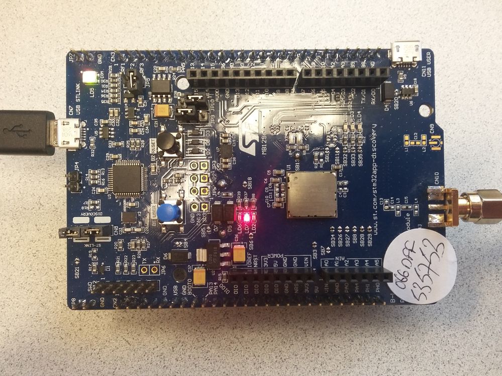

LoRa Discovery Kit
STM32L072 and LoRa Discovery Kit featuring Open LoRa module by Murata using STM32L072CZY6TR MCU
http://www.st.com/en/evaluation-tools/b-l072z-lrwan1.html
Features
The AT_Slave example (creates AT modem via ST-LINK VCP) is about 41KB in size

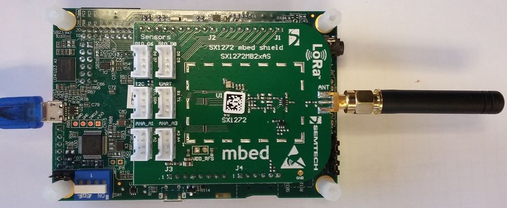

2017-09-12 1:25 PM
LRWAN successfully ported to assorted STM32F4 boards using the SX1272 shield
NUCLEO-F401RE (64)
NUCLEO-F429ZI (144)
NUCLEO-F446ZE (144)
MDOT-915 (Multi-tech F411RET6 based SX1272 design)

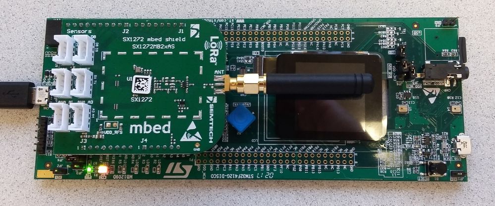

2017-09-15 1:28 PM
STM32F412G-DISCOVERY

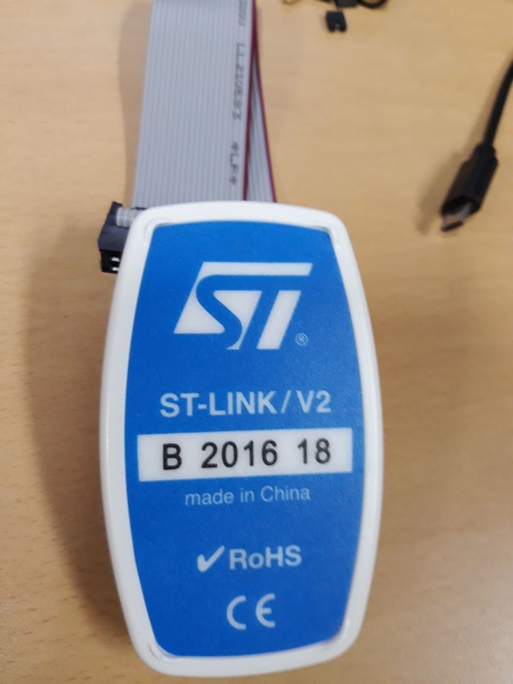

Hi Clive
I don't know how to connect to the ST kit B-L072Z-LRWAN1 through USB to my PC. In attached image, i connect to my PC and don'tload usb driver of st-link/v2-1. It don't connect. please show me the image of connecting your PC with target board of the ST kit B-L072Z-LRWAN1.
Thans for your help. David
2017-10-03 2:29 PM
Make sure you have current drivers, they should install as part of the ST-LINK Utilities package, or as the driver only package. You should see 4 or so devices come up related to the ST-LINK, VCP and MSC, etc
Connect directly to the PC, not via a hub. Try another cable, or USB port.

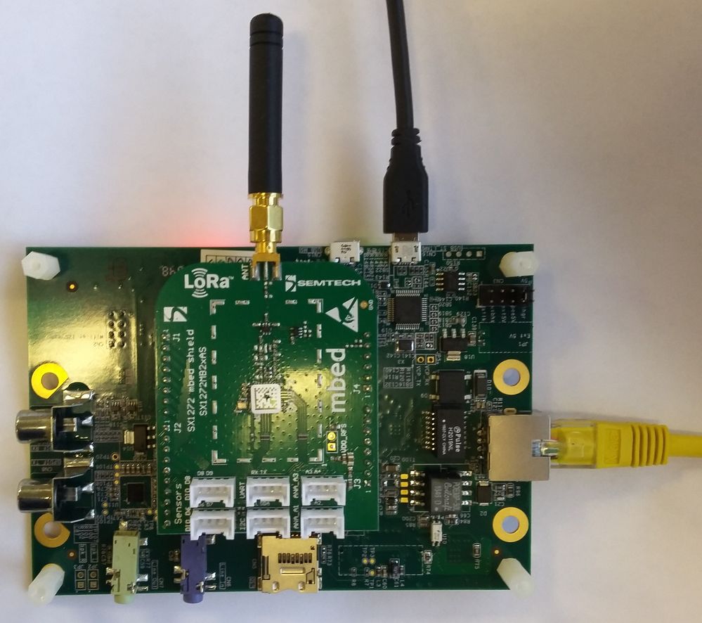

LRWAN successfully ported to STM32F769I-DISC1 board using the SX1272 shield.
PoE powered node.
