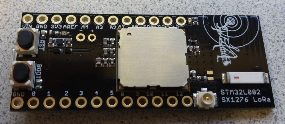

https://www.tindie.com/products/TleraCorp/grasshopper-development-board/
Kris Winer has shrunk Arduino type functionality into a minimal footprint using the Murata module.

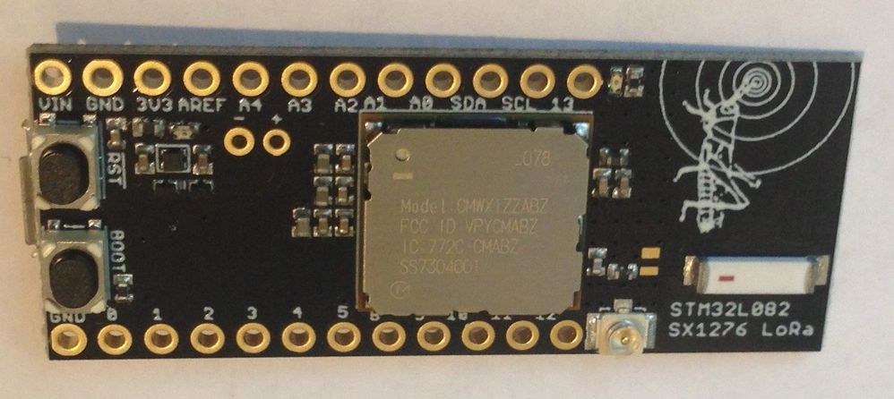

The Grasshopper boards also arrived today, shipped very quickly/efficiently. The 5 dBi antennas arrived as well.
2017-09-01 1:25 PM

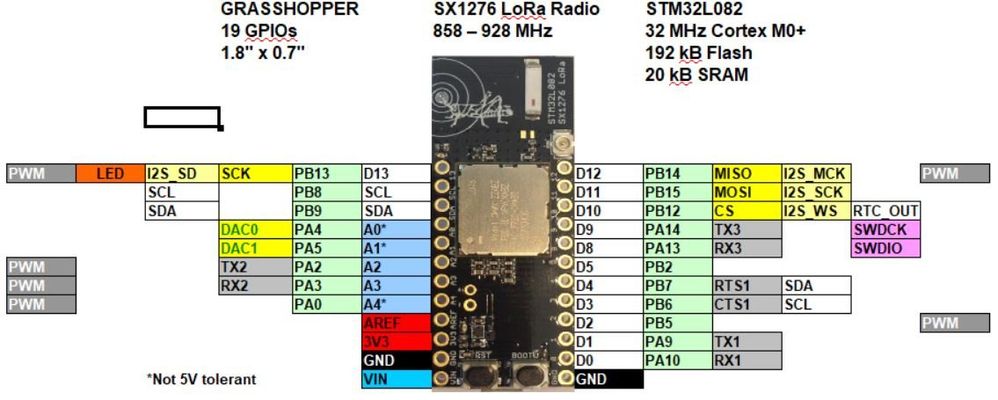

Ported code to the Grasshopper, had to change TCXO enable to PH1.
PB13 is LED
Schematic looks to be wrong, SWDIO is D8, SWCLK is D9
DFuSe 3.05 doesn't seem to work properly with the STM32L0
USART2 works on PA2/PA3, hooked that up for debug telemetry, equivalent to B-L072Z-LRWAN1 discovery board.
