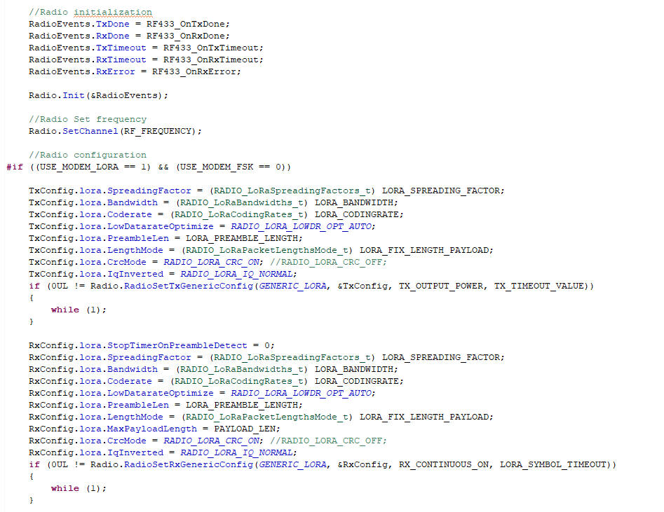

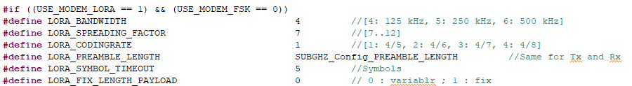

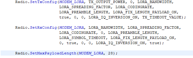

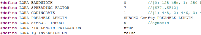

malarab
Senior II
I tried to configure lora modulation on an other way, but always the same problem !
pleas find the code below
