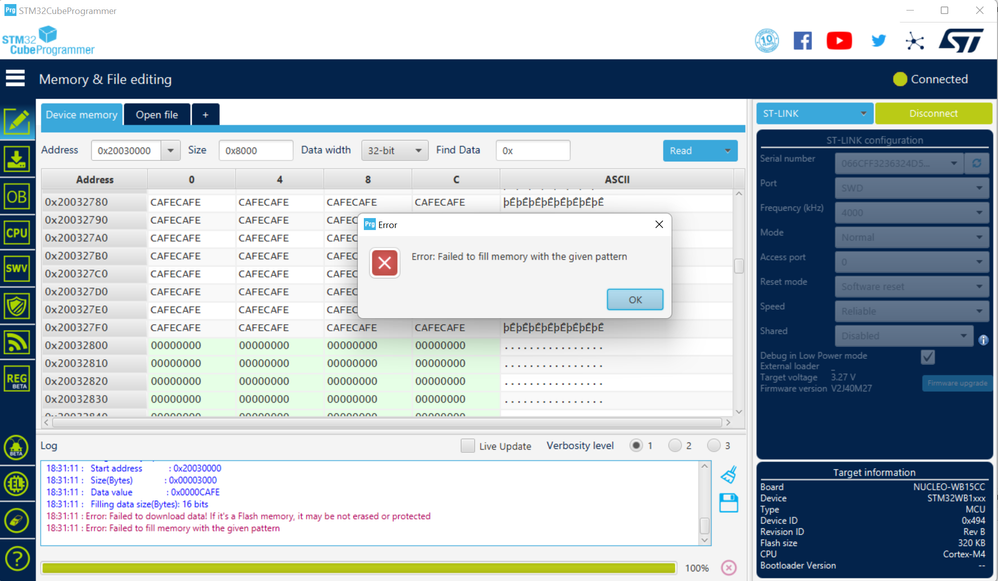

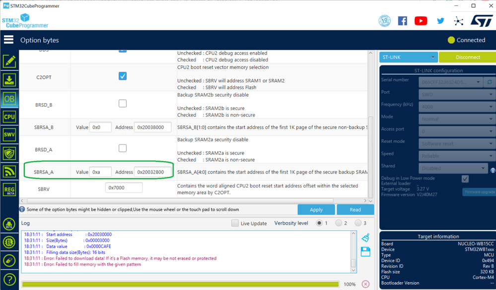

I then used the tool to read out the values of SRAM 2a, but as expected, saw only 0x00 for the area secured by the option bytes. I attempted to fill this region with 0xCAFE, but the CubeProgrammer failed to write to the protected region. I first tried filling 0x2800 bytes (which is the unlocked size) and that succeeded. I then attempted to fill 0x3000, but that failed as it hit the protected area.

In fact, the 2 option bytes defining the start address of the protected area for SRAM2a and SRAM2b are set by the wireless stack only. So, there is no way for any application on the M4 core to access/modify them.
The only way would be to get a piece of code that would set them to the top of the SRAM memory. But we do not have such code.

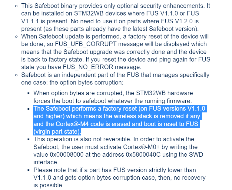

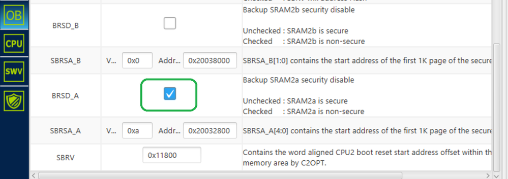

I never got around to loading any of the RF stacks. I found this info about 'Safeboot' and tried both the FUS "FW Delete" and then tried to force the safeboot by writing the value 0x00008000 at the address 0x5800040C.

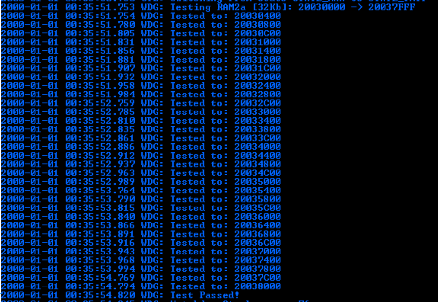

After I rebooted, the SRAM2a security was disabled and I was able to test access to the full range of SRAM2a. This unlocked 32 KB, combined with the 12 KB of SRAM1, gives me all the memory I need for now. SRAM2b was still locked, but it is small enough that I don't care about it.
I tested access by reading every location in the range and then writing the same value back again.
I am not sure which of the two steps did the actual unlocking, but it is the end result that counts!
