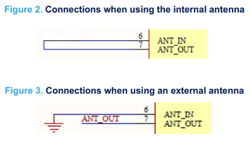

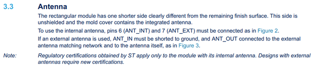

I'm in the process of developing a device using the STM32WB5MMG, and I have a query regarding the wireless testing method for the final product.
I need to conduct tests using an antenna (external antenna) approved by the certification body rather than utilizing the built-in antenna on the MCU.
Could you please confirm if there is an option similar to STM32WB1MMC where external/internal antenna selection is available, or if there is a method to use an external antenna?
I have attached the antenna options section from the datasheet of STM32WB1MMC for reference.
Thank you.

I checked what you said. Thank you for answer.
I have one more question, Is there any way to remove the internal antenna?
2024-03-25 12:31 AM
the internal antenna is integrated on the design. so, it is not possible to remove it.
Best regards.

@KWOOJ wrote:Although we obtained wireless certification for our modules, we were informed by the certification agency that additional wireless certification was required for the final product. Therefore, since there is no internal antenna function (sic?), wireless certification of the final product must be performed using an external antenna.
That doesn't make sense!
It's been established that there is an internal antenna - so, surely, certification can proceed using that antenna?
Many products achieve certification with only internal antennas.
@KWOOJ wrote:I need (sic?) to conduct tests using an antenna (external antenna) approved by the certification body rather than utilizing the built-in antenna on the MCU.
Why do you think you "need" that?
If the product has only an internal antenna - no facility for any external antenna - then it should be certified using that internal antenna.
I think something has got lost/misunderstood in translation here ...
