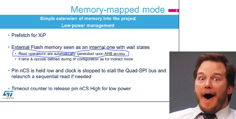

Hmm. According to that picture, DMA1 and DMA2 are connected to QSPI, but not clear does it mean access to only the registers or to memory mapped area too. Just try it ?

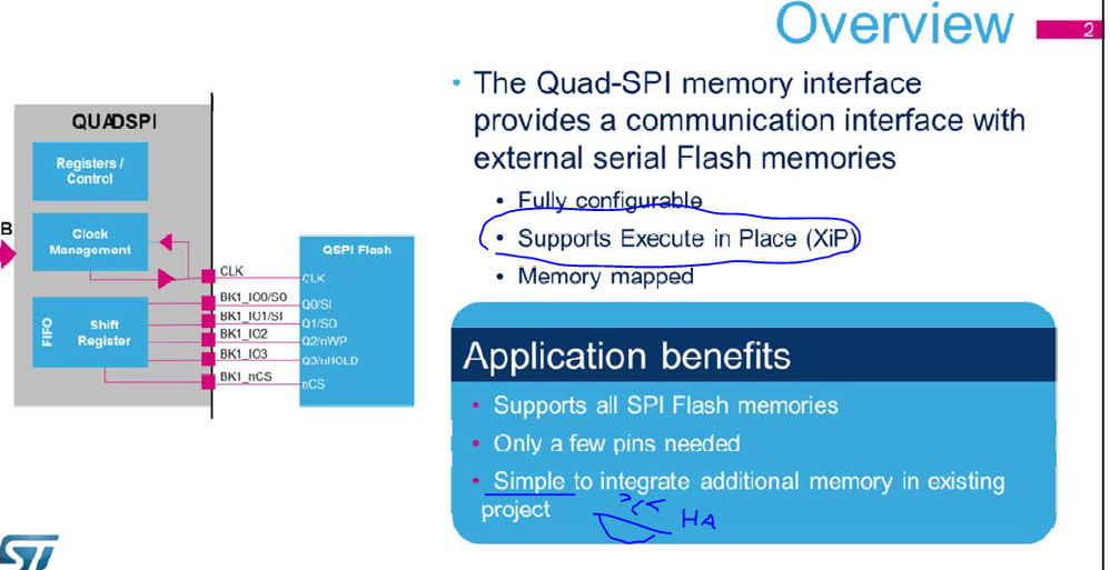

2023-01-10 9:45 AM
Nice, a family specific tutorial
no idea what xip is, sounds cool
jumping to AN4760
