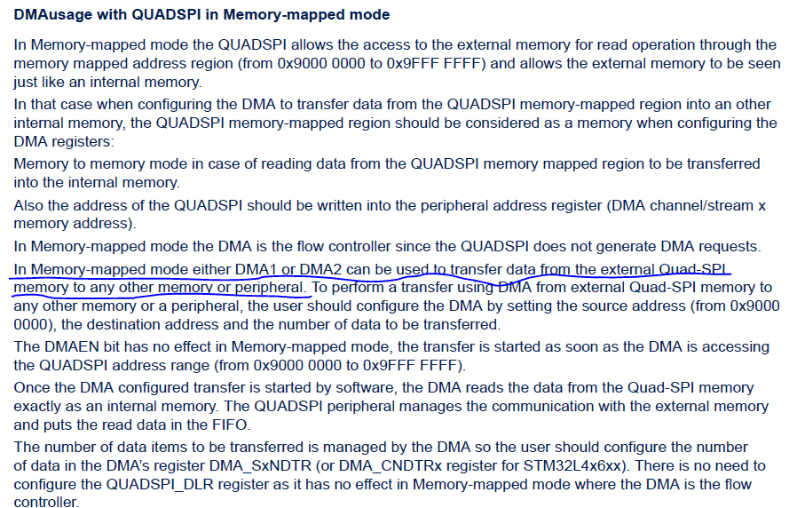

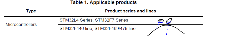

https://community.st.com/s/question/0D50X00009Xkig9SAB/dma-confusion-external-memory-access
2023-01-09 4:25 AM
Quick read to:
AN4760 Quad-SPI (QSPI) interface on STM32 microcontrollersStill a bit foggy..... it looks like we could use DMA to access QSPI external flash memories.
Lets see how straightfoward it actually is
there is a posibility STM32WB doesnt support this

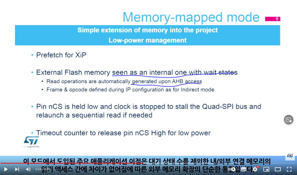

whatching ST video:https://www.youtube.com/watch?app=desktop&v=4Yck17zU2u4
It could indicate we could use DMA with it ONLY READ OPERATIONS (which is fine by me)

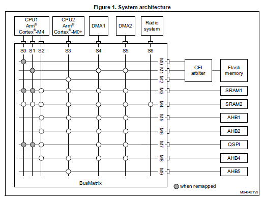

The fine manual usually has the bus matrix picture, it shows which DMA is connected to which memory or module. Look at that. I don't have the STM32WB, but if its HAL QSPI library has DMA API, it likely works with DMA (though not in memory mapped mode).

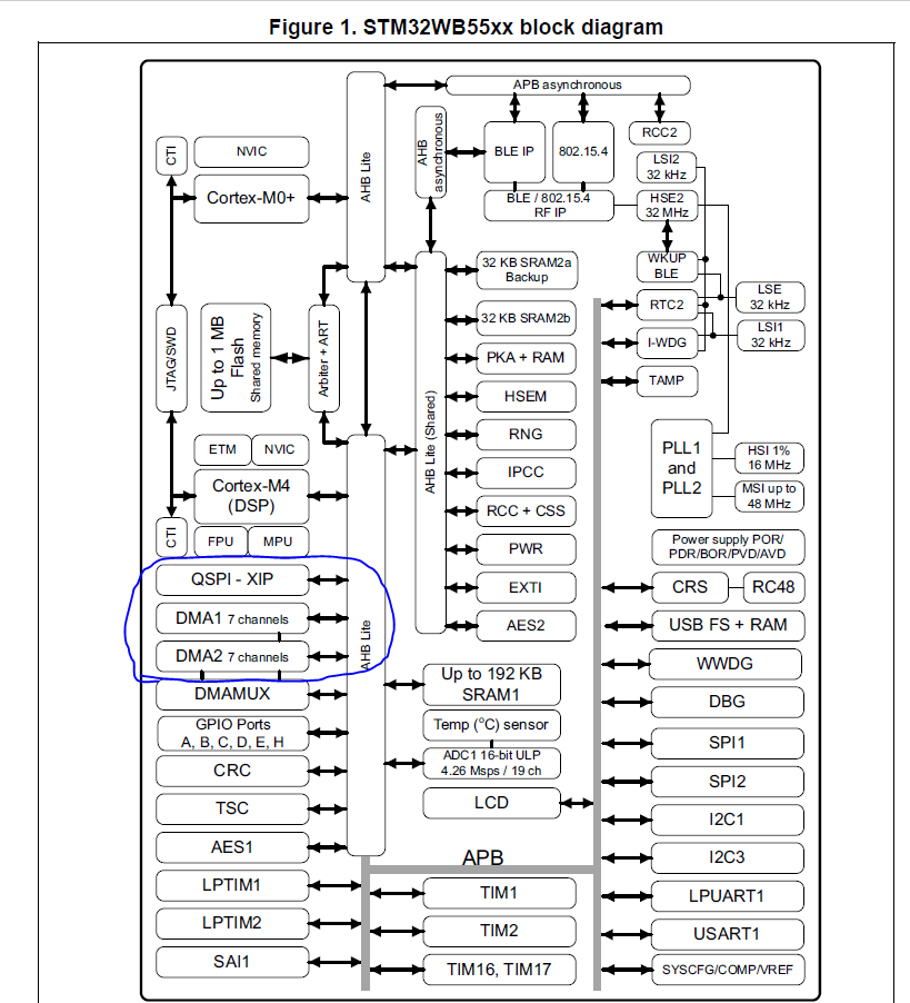

2023-01-09 1:37 PM
This is a block diagram. Is there another picture for the bus matrix ?
2023-01-09 11:46 PM
Found it in the ref manual page 64
What information do you want to get from the bus matrix picture?
