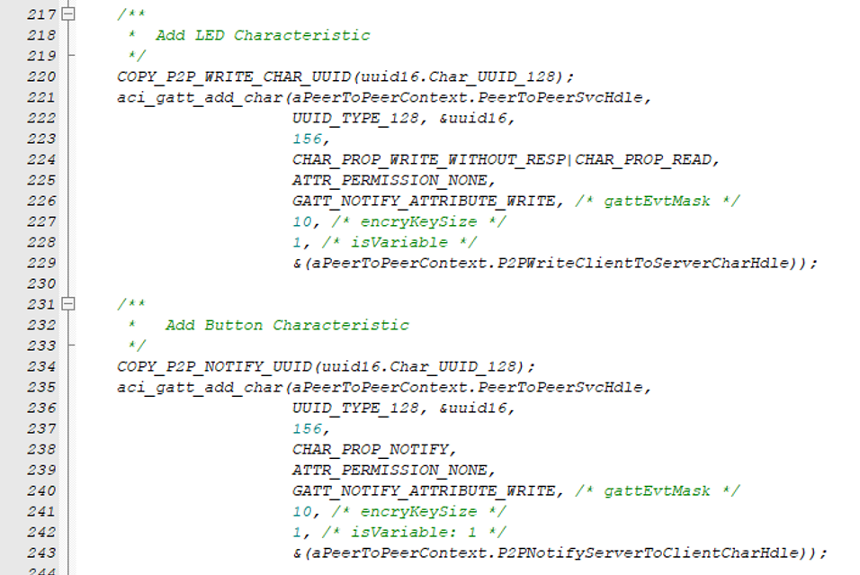

These are the service and characteristics in the server side. I use the default one. I only changed the CharValueLegth parameter and set ATT_MTU to 156
In the file p2p_client_app.c the issue was when in the I changed charValueLen in the function
tBleStatus Write_Char(uint16_t UUID, uint8_t Service_Instance, uint8_t *pPayload); and I set ATT_MTU to 156
ret =aci_gatt_write_without_resp(aP2PClientContext[index].connHandle,
aP2PClientContext[index].P2PWriteToServerCharHdle,
156, /* charValueLen */
(uint8_t *) pPayload);
When I put charValueLen to some number more that 3, the client board cannot send notifications any more.
