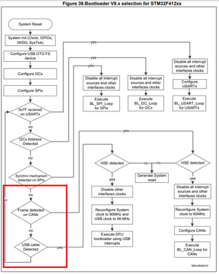

Not sure I catch the point.
But according to the AN2606 / Figure 39.Bootloader V9.x selection for STM32F412xx:
CAN has the priority on USB DFU:
So to prevent the CAN frame detection while entering system bootloader, you need either to change the CAN pins and select other alternate functions or disconnect the CAN from the bus.
Hope I answered your question.
