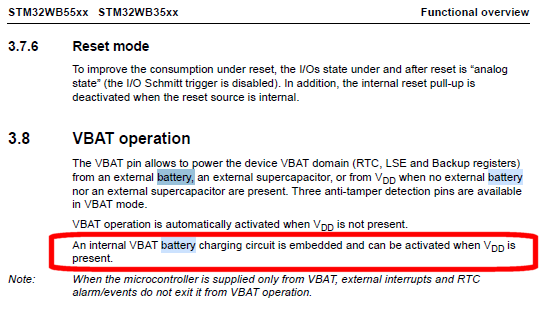

I'm developing STM32WB55VQ power system but I wonder the microcontroller automatically use battery power or not when Vdd is cut.
Is there anybody can explain this?

@KKIM.6 " I didn't know that the wb55 can charge battery."
Really? it's clearly stated in the datasheet:
But note that's only the backup battery/supercap - not any main system supply battery

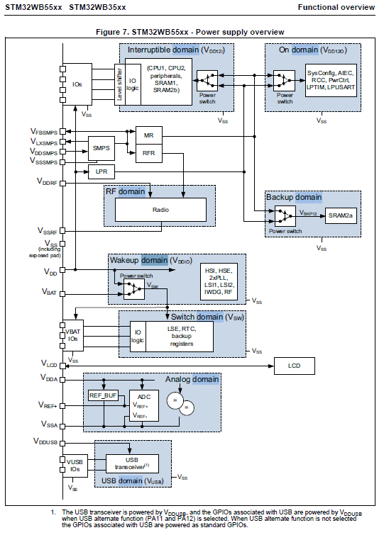

Note also this diagram showing the different power domains - ie, what gets powered from which supply pins:

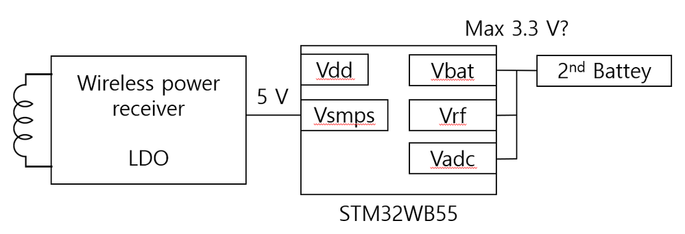

My final question is whether the power line below is possible or not.
If it is possible, I don't need PMIC/battery charger between power receiver and microcontroller.

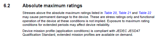

I wonder what's happen if apply more than 4 V.
2022-07-07 7:07 AM
Again, the datasheet tells you that.
The 4V is the Absolute Maximum rating; the datasheet defines that term:
