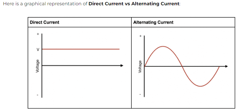

2022-07-07 6:48 AM
Go on.
It clearly tells you that the minimum input is, essentially, zero and the maximum is 4V; so that can't possibly be AC - can it?
https://www.circuitbasics.com/what-is-alternating-current/
2022-07-07 8:58 AM
Yes. It would be true. However, if there is a diode, I can apply half-wave but still, information is insufficient because I don't know that the SMPS has a bridge rectifier inside.
2022-07-07 9:04 AM
it tells you that the minimum input is, essentially, zero - so you can't apply AC.
Therefore you would need to provide any rectification externally.
The datasheet also tells you that it is a step-down SMPS, so it wouldn't be able to cope with a rectified AC supply - which drops to zero once (half-wave) or twice (full-wave) per cycle.
