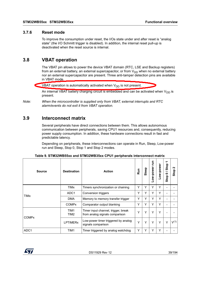

I'm developing STM32WB55VQ power system but I wonder the microcontroller automatically use battery power or not when Vdd is cut.
Is there anybody can explain this?

again, that's all answered in the datasheet.
From your other Thread:

You can use accumulator for VBAT. In some STM32 (I did not check for WB) there's even a provision for trickle charging (a switchable resistor from VDD to VBAT).
If the charger does not exceed the maximum voltage for VBAT stated in the datasheet, it is OK.

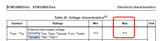

Well I suppose it means can it get upward of 4.2V, which would seem to exceed expectations. Where the nominal range is 1.55 to 3.7 V, and a max of 4V
Doesn't the SM32WB55 provide for battery charging on VBAT vs VDD internally?
One could presumably mux multiple supplies via diodes, but there are obviously considerations there too. A diode drop would afford you a little headroom on the upper voltage expectations at the IC.

VBAT pin supplies only RTC.

There's no provision to switch between different VDD sources, and they must not exceed voltages given in DS. Design of VDD power source is entirely upon you.
