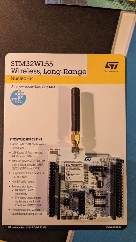

I find this Nucleo Board is very picky as to what USB cable I use. Some cables I use that work on other borads will not work on this one. When I find one that works, STMCubeIDE does not recognize there is anything connected. The board does show up as a storage device on windows file manager. It has 2 files, FAILED.TXT that contains the contents "The interface firmware FAILED to reset/halt the target MCU", and DETAILS.TXT that contain "Version: V255J255M255B255S255
Build: Nov 2 2021 16:57:17"
STM32CubeProgrammer does kind of see it because it finds a serial number for the board but when I hit the connect button it fails with No STM32 Target found. I see there is a target voltage listed of 3.26V.

This is an official Nucleo-64 board I purchased from Mouser a week ago, see pic above. When you say "Try with a real STLink." do you mean use another ST-Link to program the STM32WL55 microcontroller or use another ST-Link to update the firmware on the onboard STLINK-V3E MCU? Because I would like this to work as it was manufactured by ST. I would like to fix the STLINK-V3E MCU. Is there a way to upload the appropriate firmware any other way?
