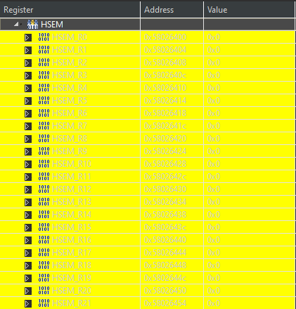

Because i've check it with debugger
This is state before calling HAL_HSEM_FastTake:

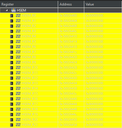

and this is after:
As you can see all semaphores has been locked by main cpu
2020-05-23 7:37 AM
Reading the RLR (read lock register), which you are doing by examining the value in peripheral mode, will lock the semaphore. Disable the RLR registers from being viewed.
2020-05-23 8:23 AM
Oh you are defenitely right, viewing in peripheral mode does lock every semaphore. Thanks for clarification!
