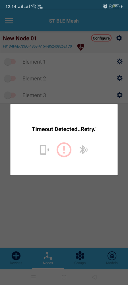

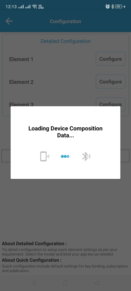

The provisioning completed successfully, but Couldn't configure the node.
The BLE Mesh app trying to get Device Composition Data(Loading Device Composition Data),but it can't.

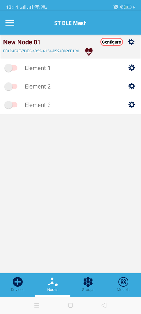

Device is provisioned by provisioner

We tried IOS ST BLE Mesh App with an Iphone 6s on IOS 14.0 and the STM32Cube_FW_WB_V1.8.0(three elements per node) , but the same problem occurred again. Couldn't configured the node after provisioning.

Do you have the same trouble during Loading Device Composition Data ?
