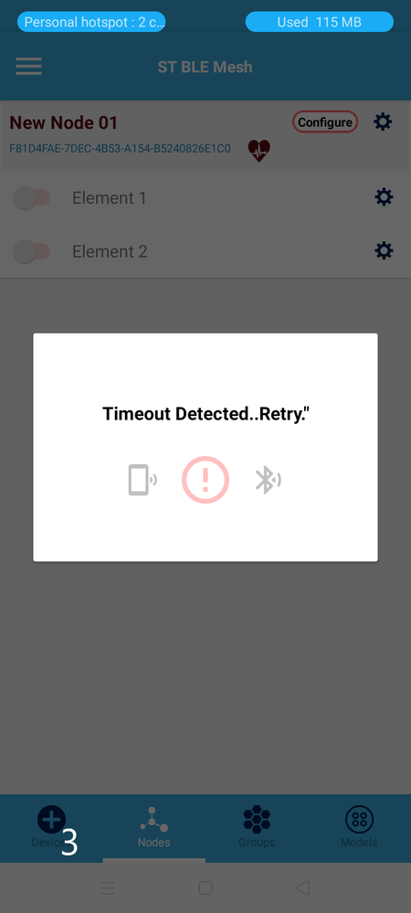

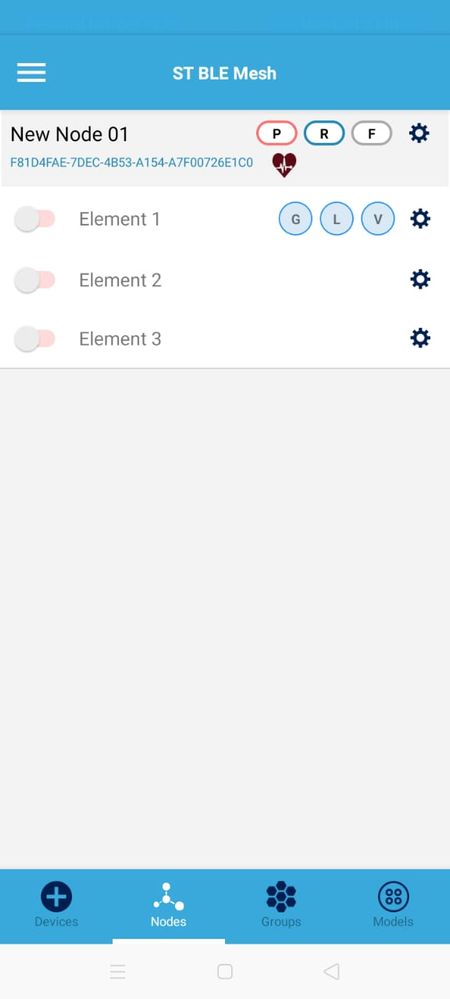

So, I edited APPLICATION_NUMBER_OF_ELEMENTS to 3, I loaded the code and provisioned the node, during the configuration step(adding the publish and subscribe address) in ST BLE Mesh app the app stopped. I reopened the app and the screen is like this (added image), I do not know what happened, what happened to Element 2 and Element 3?
I controlled Element 1(Blue LED on the board) but when I clicking on Element 1 or Element 2 ST BLE Mesh app is stopping always. And I can not assign publish and subscribe address to them, it's failed.

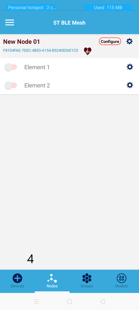

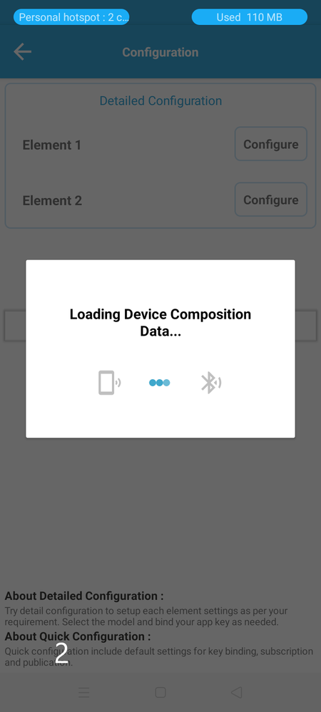

Hello Remi QUINTIN,
I edited the code as you mentioned above, but it doesn't worked. After provisioning the node the BLE Mesh App waited Loading Device Composition Data.... stage. After a lot of time it return to main window without configuring the elements, I tried a lot of times but I can not configure the elements.

2020-09-24 3:38 AM
Hi EMECH ,
Thanks for your reply.
I set the APPLICATION_NUMBER_OF_ELEMENTS to 3 as you mentioned above, but it doesn't worked. The BLE Mesh App waited in Loading Device Composition Data.... stage After provisioning the node. Mesh App returning to main window without configuring the elements, I tried a lot of times but I can not configure the elements.
