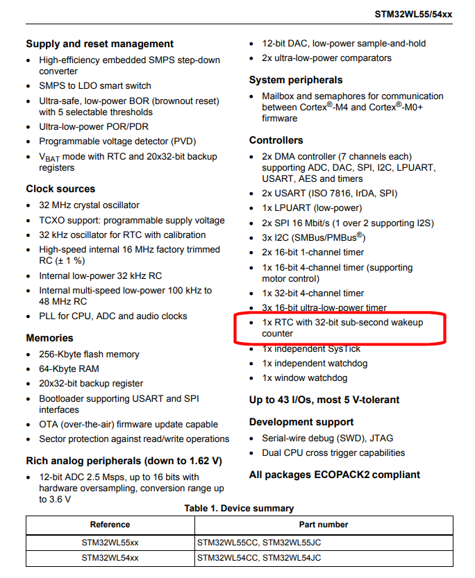

@Sivanand wrote:I’m working with an STM32WL55JC1 board .
What board, exactly?
@Sivanand wrote:STM32 has no RTC module.
Yes, it does:
2026-02-01 9:50 PM
