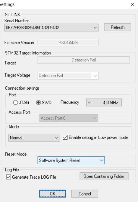

Then I installed STLink Utility . I can`t connect using that either. I can the STLink version number but STM32 Target shows `Detection failed` . Target Voltage `Detection fail`
Jp1 1-2 is fitted and I got 2 red LEDs on .
Do you have any idea what might have gone ?
