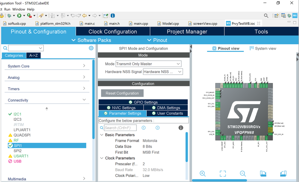

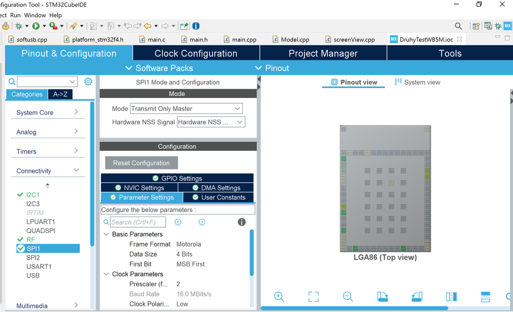

Stm32cubeIDE have same wizard for config board simply click on SPI and setup for example
