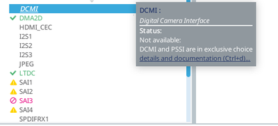

i am traing to enable the DCMI in the STM32H743BGT6 whit the stmcubeIDE (in the cubeMX section)
and as you can see in the image above, the program does not let me enable the DCMI because its resources are used by the "PSSI" (which I NEVER enabled, and I imagine that it is an initial configuration by default)

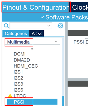

and according to this tutorial: https://community.st.com/t5/stm32-mcus/how-to-configure-and-use-the-pssi-on-the-stm32h7/ta-p/49811
I should be able to disable the PSSI (which I don't want) in the section you see in the tutorial image
but I can't because that PSSI is NOT in that part, nor can I find where it is to DISABLE it anywhere in my stmcubeIDE (as you can see in the first image I posted)

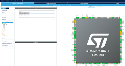

There is no PSSI interface on STM32H743 part number.
I opened your ioc file with the standalone CubeMx and as you can see there is no PSSI in the list.:
2025-10-07 3:01 AM

1- But in the image you shown at the beginning there is a PSSI in the list! and the question was why there is a conflict between DCMI and PSSI.

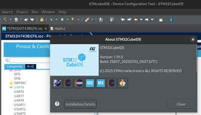

Now the question is what CubeIDE version are you using?
sorry, this is a imagen from this toturial, not from my computer:
2- With your ioc file, I can enable DCMI without any issue as there is no PSSI at all. Now the question is what CubeIDE version are you using?
this version:
