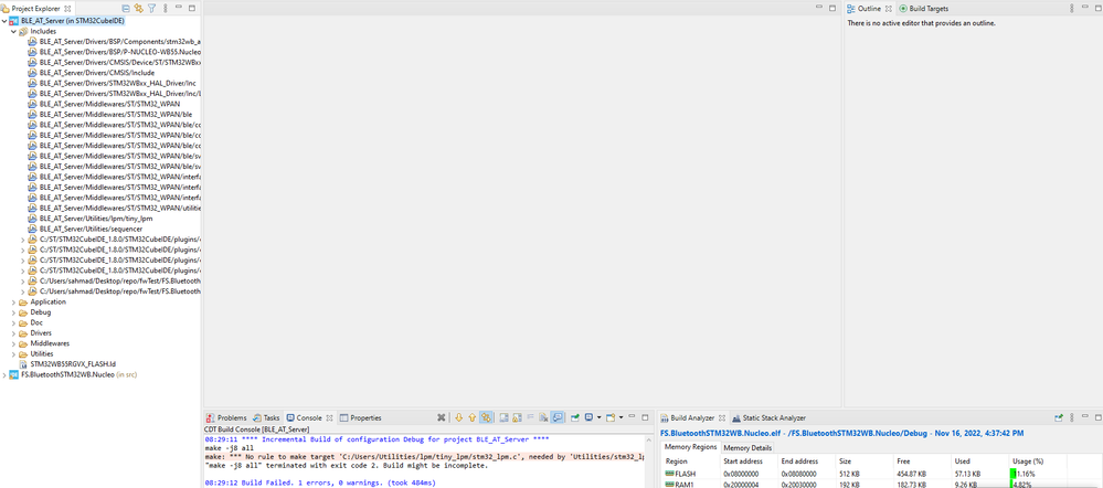

2022-11-16 11:30 PM
I have solved the path issues but still error exists. Here is the screenshot.
2022-11-17 12:32 AM
Can you try with the latest STM32CubeWB package (v1.14.1) and the latest version of STM32CubeIDE (v1.10.1)?
Best Regards
