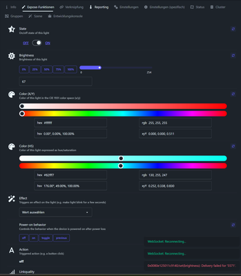

The device shown in zigbee2mqtt:
I attached the full app_zigbee.c file aswell.
Maybe one has an idea whats going on here, as all other function callbacks are working as expected. Its just the color stuff :)
