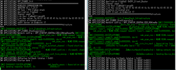

From the debug traces output by the USB VCP below shows that the onOff Server cannot receive any SW1 action sent by the onOff client. How to debug this type of problem since both server and client looks like link up to each other now. Thanks.
