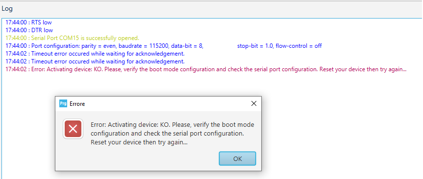

first of all thank you for the response.
actually there was no last programmed time, its the first time that im trying to program this Board.
the STM core of this board is the STM32WLE5CC. its seems like the CubeProgrammer dosn't support it.(if i'am wrong tell me )
the BOOT0 is High

Hello Takahashi,
Thnak you for the advice, i have already tried this tutorial, but i have always the same problem.

I'd expect you'd need to connect the NRST, you have one-shot at connecting using the ROM loader and serial connectivity.
Re-evaluate, and use an ST-LINK connected via the SWDIO, SWCLK, NRST, VCC, GND. That way at least you have some part to debug the code you push into the device.
