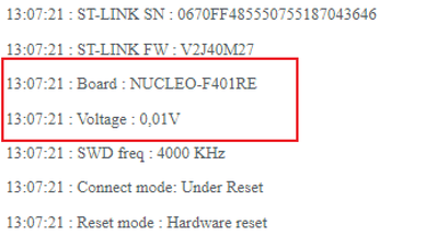

2023-07-14 8:00 AM - edited 2023-07-14 8:00 AM
Hello @ZSvet.1 and welcome to ST Community.
I reproduced the same behavior using ST-LINK FW : V3J10M3 and it works if I just put the option byte nBOOT0 to 0 before putting nBOOT1 and nSWBOOT0 to 0. Also, I suggest you to verify the Board that u are using and the voltage. After the data you have provided, I think there is a problem in this two parameters as you can see in this capture.
I hope this is helpful for you.
Issam.
2023-07-22 1:07 PM
Dear Issam,
Thanks you for your investigation.
Did you checked both MCUs?
You are correct to verify board,
but I am using cut-off ST-Link from F401RE board connected to own STM32WLxx PCB
(Outage of ST-LINKs in the past, so the need - produced that :) ).
Wiring and target voltage should be OK, considering everything is working normally on STM32WLE5:
- flashing
- debugging
- OptionByte programming 100%
Only with the STM32WL55 I have problems to program most of the option-bytes.
With other development machines, where I am using ST factory ST-LINKv2(latest FW)
I am facing the same symptoms with STM32WL55 not capable of programming some OBs.
(Have done double checking before asked here....)
As it seems your configuration is using ST-LINKv3 HW ... maybe that would be the trick.
Will order a few v3 ST-LINKs to try out.
Thanks a lot.
Ziga
