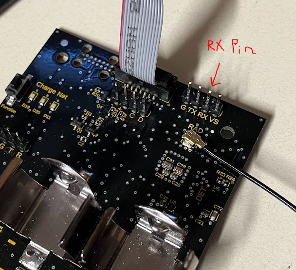

The UART2 IRQ Handler gets called consistently and never clears a few milliseconds after initialization.
If the debugger is not present on the RX line, the program always gets stuck in the IRQ Handler forever, until I touch the RX pin with my finger. Then the program begins executing normally.

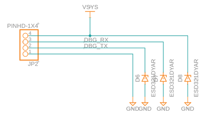

On our STM32WL5MOCH-based board, the debug port (UART2) pins are left floating.

If I touch the RX pin with my finger, the system fixes itself and proceeds with program execution - almost as if the UART error registers finally read acceptable values. When attached to a serial converter TX and RX, it never gets stuck on startup. It also never gets stuck when pulled up with a 10k resistor to VDD. Setting the internal pullup for the RX pin does not fix the issue in the function call MX_GPIO_Init();

Don't configure as an INPUT
Configure as a normal UART AF pins, with the PULL-UP setting. You need the associtivity with the UART. Or don't set the RE (RX Enable) on the UART.
You could also pull pin low, and check if an interface is connected or not.

My opinion:
A) cmos inputs MUST always be driven - otherwise they are antennas receving any kind of EMI - the best is the device, the higher the input impedence and the sensistivity
B) use pullups/pulldown provided in MCU if you do nor plan any external connection
C) disable device untill driven.

The ISR value indicates NE (noise error) is set but since EIE=0 this shouldn't be triggering the IRQ handler.
If the above is true, it would indicate a silicon issue (IRQ triggering despite no relevant flags set), not a software one. I would want more evidence before believing that though. HAL isn't calling Error Handler because EIE isn't set, which is valid.
Since it happens right after TIM16, my guess is noise from a timer channel is causing other issues on the line besides NE. Probably FE.
As @Tesla DeLorean says, solution enable the pullup on the pin so the signal is valid when the line is not connected.

You are correct: configuring the RX pin as a pullup in the HAL_UART_MspInit() function generated by CubeMX consistently prevents the issue. We changed the GPIO pullup setting and regenerated the code using CubeMX rather than adding the line manually.
